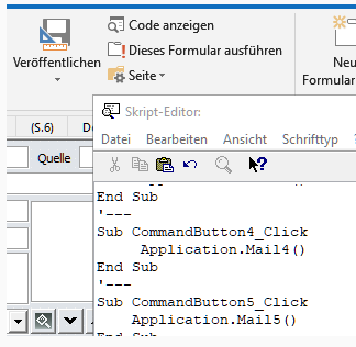

I have created a button and want to know how I can start a macro by pressing this button in the form?
The code for the button is in the Outlook forms VBScript editor!
Code:
Sub CommandButton4_Click()
   CODE NEEDED!

You want to start the AddNote macro by clicking commandbutton4?
Try using Call AddNote - but you also need to adjust security settings so the script will run.
You may need to have the AddNote macro in the script editor rather than as VBA.
You need to set some registry keys to use vbscripts.

The macro for testing is in ThisOutlookSession ( in German version DieseOutlookSizung)
What I tried in the meantime:
What's the matter here?
Do I need some more libraries
Or has Microsoft also blocked something that Prevents the macro to be called and from running

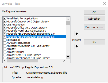

I'll test it, but I think the problem is that you can't call a macro from the form script.
Regular expressions is used for regex code - it's not needed for this.

You can call macros from VBA - but not from the vbscript in a form. (VBA and vbscript are two different programming languages).
