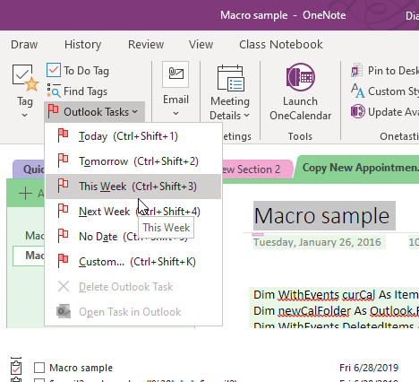

The difficulty is that quite often I am in onenote writing notes, and I think I would like to remind myself. So it's within onenote, where I would like to set up a reminder linked to my notes, that automatically feeds the reminder to outlook. That's, what I am trying to do.
The command to create a task should be on the Home tab with the other tabs. Also verify the onenote addin is enabled in outlook.

onenote is enabled but the problem in outlook is that I cant see the onenote notebook that I am using, it links to another one I dont use.
also in onenote I am using the tabs aren't the same as yours.
In Onenote File > Options > Send to onenote, is the wrong notebook set as the location ?
