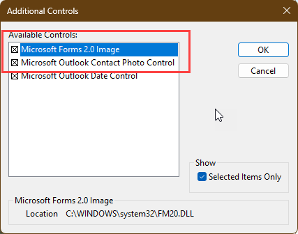

Right c;lick on the control toolbox - then custom controls to get that dialog. It will have a lot more in it - I enabled Show selected items for the screenshot.

ok, now with your instruction i get to the right menu at least - but dunno what to do there...
Browse the list - the Forms 2.0 image control should be checked - also find the outlook contact photo control and check it.
Then add it to your form and run it to test.
